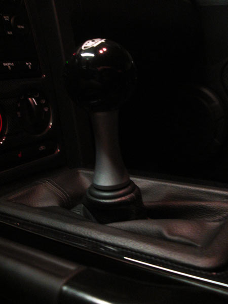

MGW's adjustabitliy is a big sales point but I found that some of this adjustability is not usable. you can roate the shifter arm left or right (to and away) from the driver, I was really excited about this as I wanted the shifter arm to be closer to me cause it hurts my shoulder some times. If the shifter is adjusted closer to the driver, then the arm would hit the center console and prevent you from going into 1st gear. This adjustment may have worked well in
previous gens of the mustang but it doesnt work well in the S197. One of the pictures I have attached shows the contact between the shift arm and the console to help illustrate what I mean. I tried both a standard shiftknob and MGW's shift arm and experienced this issue with each of them.
The hight of the shifter arm heght is a VERY usable adjustment, At first I had the arm height very low, it looked really slick and small but utlimately I adjusted it to be much hgher as I found I can still have a short throw adjusted but gain the extra leverage from the taller arm height, this proved to be the best equilibrium along with the 7 turn setting.unlike the steeda tri ax which only has 2 hieghts the MGW is almost adjustable from very low where the arm hits
the shifter or very hight where the shift arm has extended to its highest usable point.
