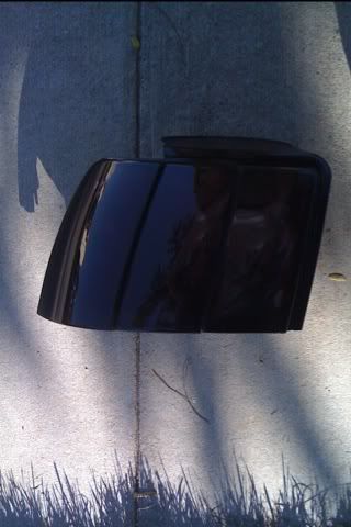

First go to any shop that sales R/C Cars they will have the paint you need.
I bought the Testors R/C car window tint PART # RC294
I wet sanded the tail lights with 800 grit sandpaper. i had tinted the tails before but they were to dark
I then re sprayed the tails with one coat to see if it was dark enough for my liking
You can spray more times but I wouldn't go anymore than two coats. the first time I did four and it was dark. You could barely see the brake lights in the daytime.
This one is two coats direct sun light.
