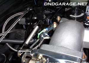

- [FONT=Arial, Helvetica, sans-serif]Now your ready to mount your WOT switch. As you can see I connected the mounting rod to one of the bolts on the plenum, then bent it so the metal rod on the switch would hit a piece near the throttle cable at WOT. Use the bolts and nuts supplied with the kit to mount the switch to the rod.[/FONT]
